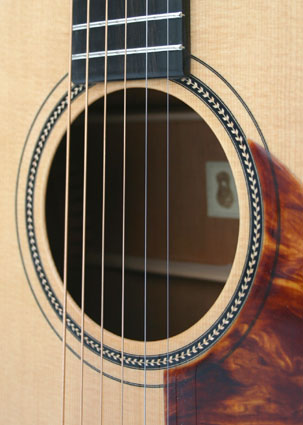

Here is a picture of my first guitar. You can get a nice matching rosette too.

I also just bend the herringbone dry, with no heat. I used to mess around with the bending pipe and the Fox bender and special forms, but it turns out it really isn't necessary. Here's a simple rosette where I just installed the herringbone and purfling lines dry, put some "Hot Stuff" on everything and Voila! The 5 minute rosette. It is a good idea to seal the rabbet with shellac before gluing, so add time for that!
